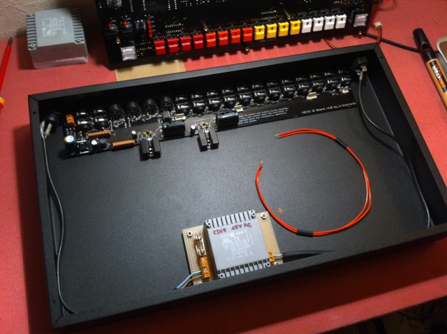

    check those pics :
    cabling inside the yocto
    cabling inside the yocto Viewed 19734 times
    fuse could be before the transformer (ideally) but it is expensive for 80/160 mA (yes, i'm greedy :P )

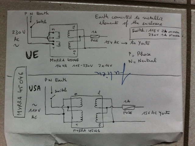

    cabling 115V 230V -> 15V AC
    cabling 115V 230V -> 15V AC Viewed 19734 times
    and finally i placed the IEC connector on left and switch on right for a centered Lexan
    finally
    finally Viewed 19733 times

    @ElSchtroumpf : is there enough room in the box for this power supply ?
    If yes i will change for a C14 connector ;)
    @misa : seems not to be too complicated, look at the the datasheet for the transformer connection and at the drawing of julienvoirin for the rest
  • My enclosure will be higher than julienvoirin's, if you use a low profile transformer you should be fine!
  • I have two questions re: Myrra: it says it's a 115-230 V transformer -- but the wiring for 115 seems to be very different from the 230 wiring.
    First off: why? (can someone explain to me in layman's terms why the wiring needs to be different for the different voltages, please?)
    second: this means that I *can't" just plug in a 110 V cable when I tour the USA, but need a step-down converter, right?
    bonus question: is there a solution that would allow me to use 110V *or* 230V? I'd like to travel with Yocto and play out live, that would make things easier (and presumably more reliable...). Otherwise it might be a better solution to use a wallwart PSU?
    Thanks!
  • some physics :
    P = U x I = constante = 14VA
    P : Power
    on primary windings :
    Utotal = U1 + U2 (voltages)
    230V = 115V + 115V
    --> a single winding has a maximum intensity output.
    secondary windings are in parallel to add intensity :
    i total = i1 + i2
    and deliver a single 15V AC of 0,4 + 0,4 A.
    you can have a DPDT switch for EU/USA conversion as used on old computer that will route the electric "path" around the transformer (remember this switch 115/220V on the rear of apparels).
    nota : windings of primary and secondary are phase opposed, explaining this crossing serial connection

    - metal cases MUST be earthed (not doing so means you potentially could have a fault that makes the case live). Julien's diagram has this noted, but I wanted to make this very clear.
    - use an internal fuse on the mains-side, not just the low-voltage side, on the live wire (not the neutral). 1A fuse would do.
    If you are unsure about the wiring for the transformer, switch, fuse etc., i suggest you simply do not attempt it. Just use the wallwart as the designer planned. Any mistake on the mains wiring could electrocute you and/or cause a fire. You also may have live wiring exposed when you have the case open while testing it etc.
    If you do attempt it, you can use an insulating "boot" over the mains socket and fuse or use heatshrink sleeving to cover it. Not important for the low voltage side.
    Here is a voltage selector switch of the type that could be used to switch the primary from series (240) to parallel (120)
    http://uk.farnell.com/schurter/0033-450 ... dp/1211994
