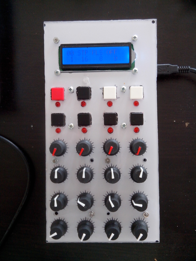

Hi,
Here the first version of an euclidian sequencer with 2 Lickogic, 1 Dilicktal and 1 Lcd.
16 tracks in 4 banks with individual note, swing and rythm_mode (POLY : ppqn = 6 (1/16th), SOLO : ppqn depends on nb_steps).
Sync / Master Midi.
Signal on Serial, Mid or USB.

Thx you, I spend hours on this. I'm going crazy :pe-licktronic wrote: What s a huge project you posted here![]()
I will... I attach some pictures to begin (you will understand BLACK_BUTTON, etc...)e-licktronic wrote: Could you post a video about possibilities of your euclidien sequencer.
No, I think it is because there was a problem on initialization with the lcd.e-licktronic wrote: Just a question , why do you not use PotMux library? Is it because of the 7 bits value conversion ?
And I'm looping only one time to read all pots. You're function loop on all pots anytime you read one pot.
Look at checkPotValues() and checkValuePotChange(byte *value, byte _value_pot, byte _precision, byte _plage)
