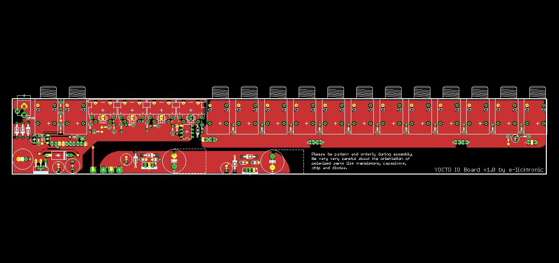

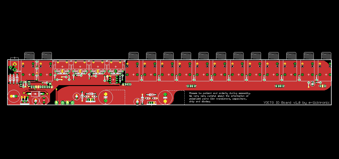

Could you post a HD picture of the IO boards ? it's possible that you get a proto IO board who had this Hummmm problem. :shock:
The first one is the good one. Jacks ground plane and Power ground are separated.

I looked at the circuit board very carefully, it looks like the correct one - I can't really get the photos to show clearly, but I will try again and post them up.
There is a separation in the copper between the earth plane (power) and earth plane (signal) as shown in the first photo you posted.
