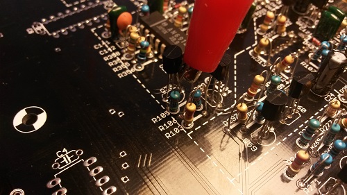

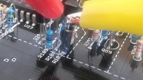

    At the end I found out that impedance from the TP on r103 (where I can attach my crocodile) and ground was 10k while on the other instruments was 32K (from accent input to ground).
    Well, following the PCB layout if you attach a crocodile to r103 you bypass r0103 and you will put 5V directly to the base of Q28 making it burn.
    My was 4TH batch, I can see differences in the shoot in building section and my PCB layout.
    If you want to use r103 TP to supply 5V accent you have to invert the wire part and the resitor part when soldering r103.
    I'm sure this is not clear, so I attach a couple of picture.
    BEWARE !
    from a circuit point of view everything was correct, the issue was only during testing.
    The PCB is correct, only the R103 soldering tip (i.e advice) was inverted.
    Can anyone confirm this ?
    Anyway, now it's working :D :D :D :D :D :D :D :D
    But the HandClap sounds like overdriven... this is bad :( :( :(
    R103 inverted according to PCB layout, attaching 5V there is ok for Q28
    R103 inverted according to PCB layout, attaching 5V there is ok for Q28 Viewed 19349 times
    R103 soldered according to PCB layout, attaching 5V there is NOT ok for Q28 because will drop 5V directly to Q28 Base
    R103 soldered according to PCB layout, attaching 5V there is NOT ok for Q28 because will drop 5V directly to Q28 Base Viewed 19349 times

  • If you follow the silkscreen, the outside of R103 will get exposed at the wrong side so you will bypass R103 (22k) and feed 5Volt directly
    on Q28's base instead of being limited by that 22k resistor.
    This will only happen when you test the instrument with an Arduino.
    Otherwise you wouldn't notice the orientation is wrong.
  • Great ikke, 100% correct
